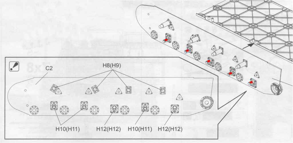

Hi Guys
I know this has been mentioned before but I just can't figure it out, and don't want to go wrong:
Just started the build on my Pzkpfw II C and don't know how to fix the following

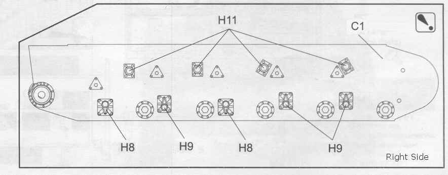

Here a part of the instructions which show how the "stops" (H10, H12 and H12) should be mounted.
The red rubber should not go on top but upside down....

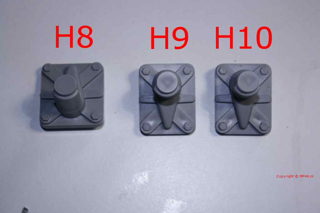

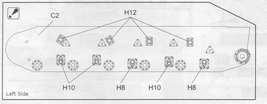

Now when I take the parts from the sprue, they have different numbers as can be seen on the following picture (H8, H9 and H10)
So my simple question is: where should I mount which piece???
Thanks for any help

Test fit each piece. Follow the illustration and they will fit where they belong. All of them mount at slightly different angles, so be careful. The wide ones obviously will not fit where the thinner ones go, etc.

Rubber faces the arm so up is the thing.
They have them upside down.

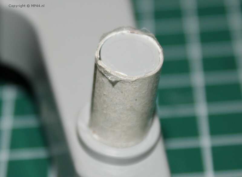

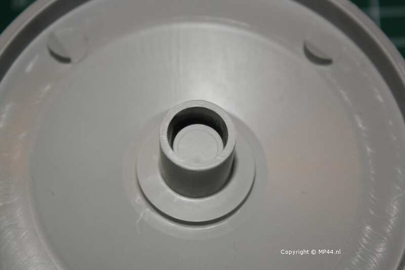

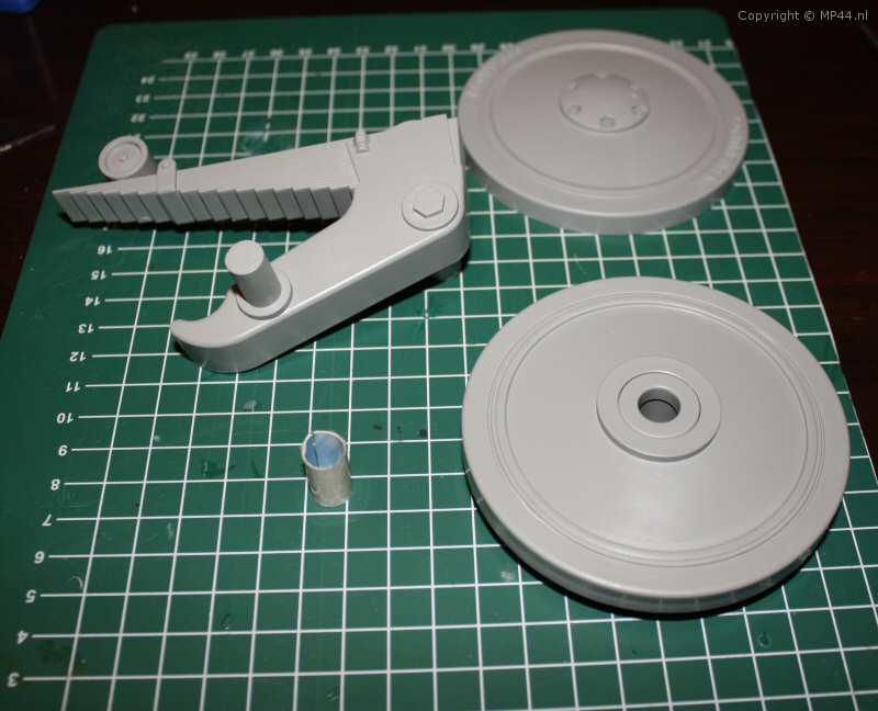

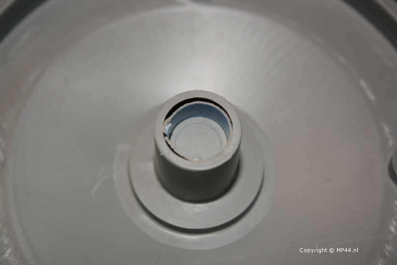

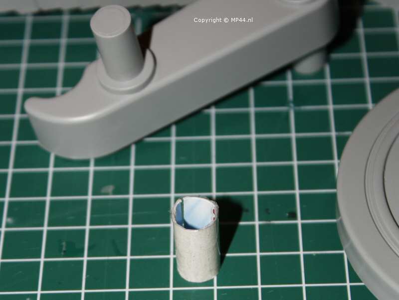

Not too much time on my hands, but I have found quite a simple way to get the wheel rotating without having to cut the wheels
Just take a piece of thing cardboard, fold it round the wheel axe and tape it together.. (piece of cardboard is aproc 3,1 cm x 1,7 cm)
You know have a small tube...
Now put the back side of the wheel on the axe and push (superglue) the tube on it...
Now you can glue the front part of the wheel on , and it turns....
I know, not a high tech solution and probably not sturdy enough for R/C, but if you just want the wheel to rotate, this is the way to go
here some pics for clarification:

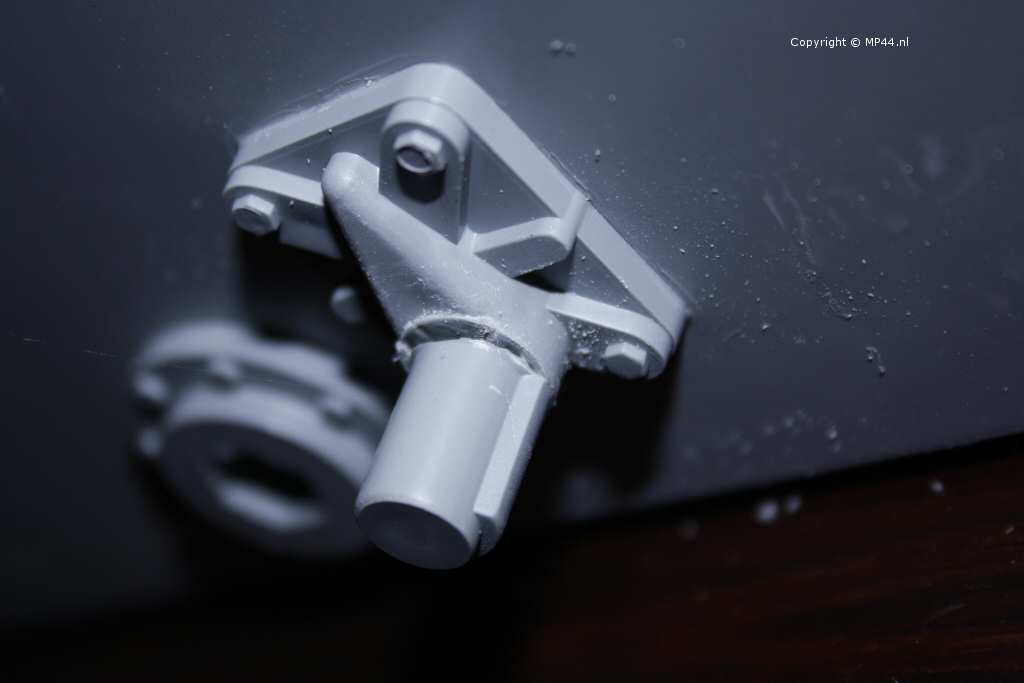

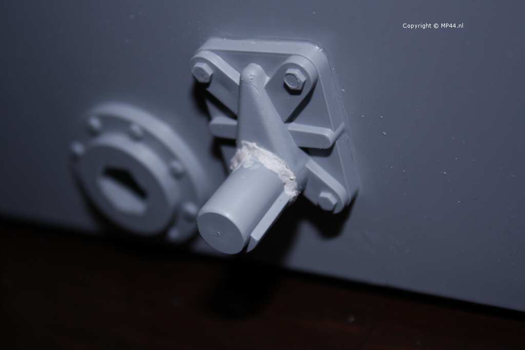

Although I don't have very much time, I decided I couldn't live with the upside down rubbers
So I took out my dremel and cut them off... I re-attached them the right way and with a lot of putty, nothing can be seen
I feel a lot happier now....
Here the pictures
Of course a little sanding still has to be done !
