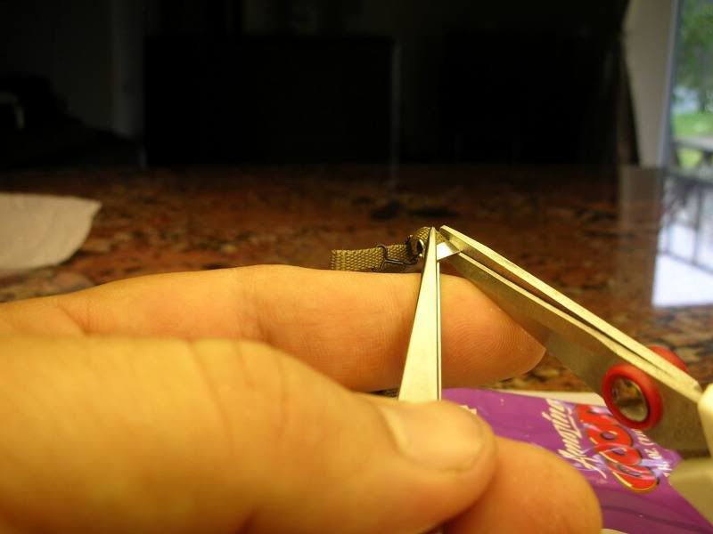

Now trim the tab. Always cut keeping the scissors on the right-hand side of the tab. This allows you to sight the blade precisely along the webbing. Cut it off exactly even with the webbing.

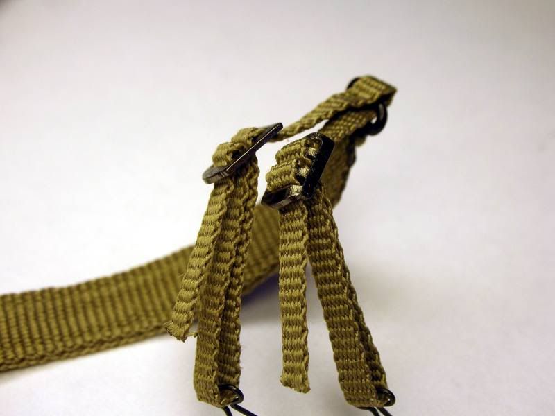

It should look like this:

Well, that's it. Nothing revolutionary, just a series of simple steps. But the difference is amazing once you do it.
